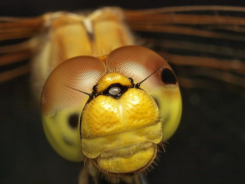

    I created the foam ring flash last year for use with the 35mm due to the fact that the entry optic was so much smaller than the barrel. Getting light on the subject was easy from the sides or top, but frontal illumination was impossible.
    The foam ring flash fixes this by placing the diffuser all the way around the opening while a FL 20 is fired directly into the ring. The bottom of the ring is dimmer than the top but still transmits light on the subject.In Daves picture above you can see I was using a piece about a half inch wide although all that is needed is a width big enough to cover the emitter on the FL 20.
    So here it is.

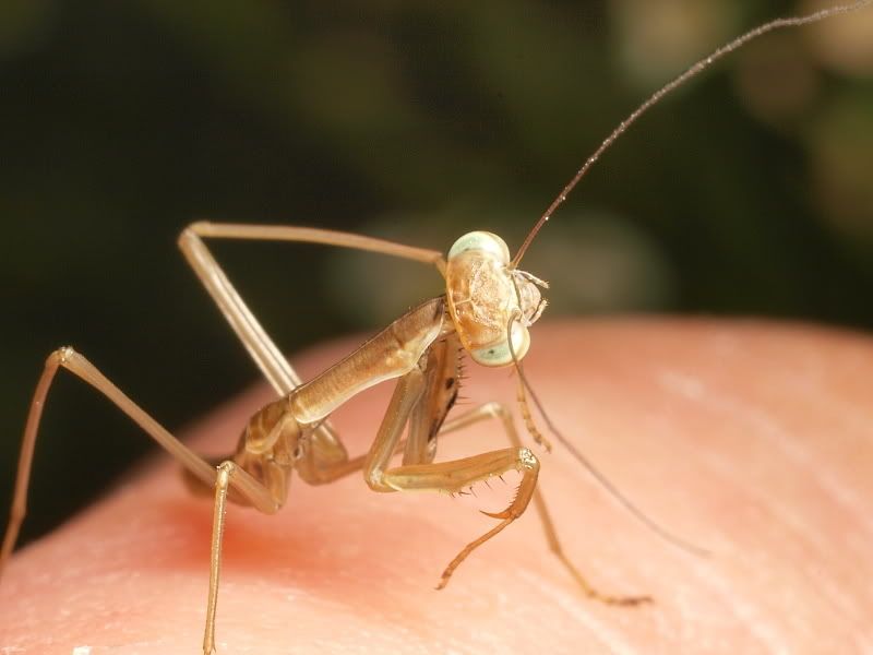

    This newly hatched mantid nymph didn't mind sunning itself while I shot.

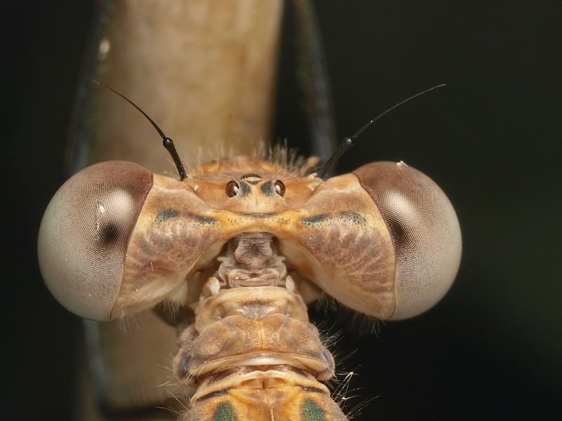

    I find that the way damsels perch, that it is hard to get facial shots.
    Some results

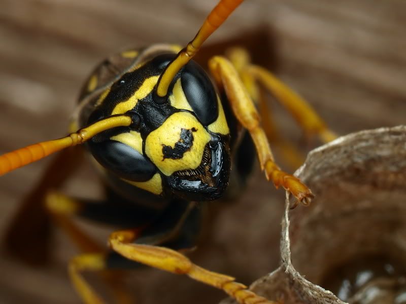

    I'm lucky that this one was busy building her nest but she wasn't staying still either.
    Dragonflies are more co-operative
    more in next post
